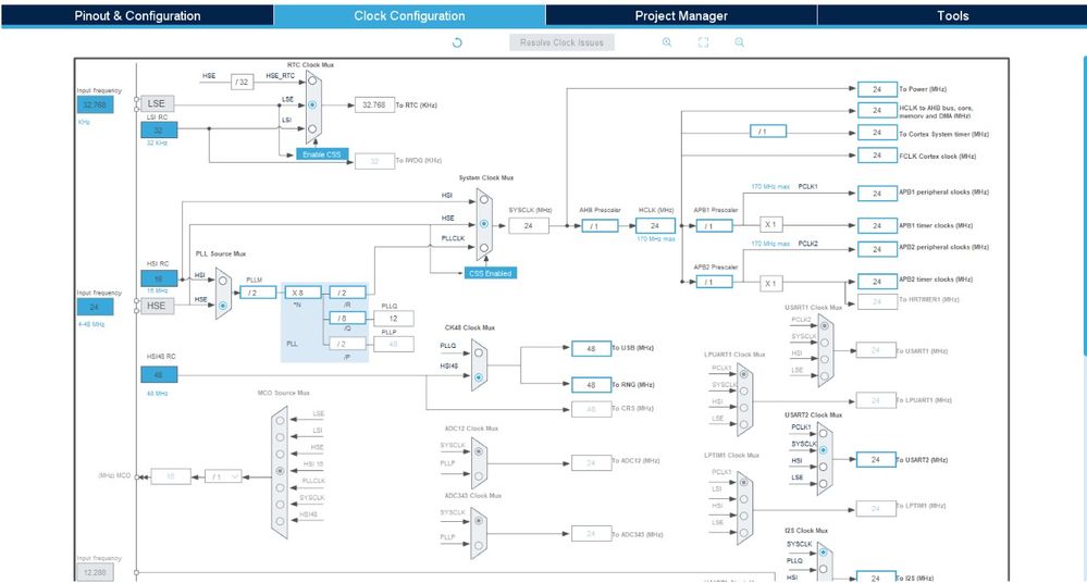

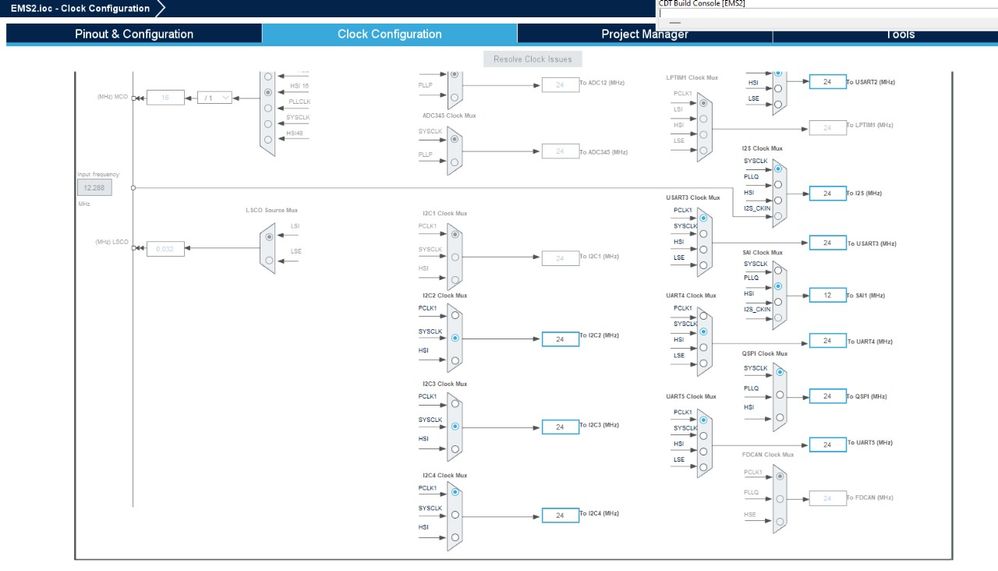

2024-10-13 2:36 AM
Here's the screenshots for the same!
2024-10-13 5:38 AM

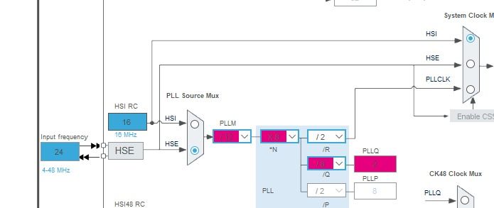

SAI uses integer divider. You can't divide 24MHz to 2.048MHz. 2MHz should be viable though.

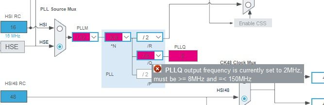

2024-10-13 5:53 AM - edited 2024-10-13 5:53 AM
We are getting error "PLLQ output frequency is currently set to 2Mhz, must be >= 8Mhz and =<150Mhz." Please see the screenshot.
How do we modify this limit?
2024-10-13 6:13 AM
Use the MCKDIV divider in SAI.
2024-10-13 6:15 AM
Will try and update you!
2024-10-19 6:04 AM
@waclawek.jan thanks, it worked!
