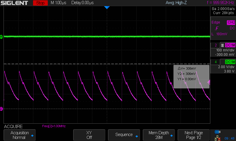

I am using a single channel on ADC1, and a single channel on ADC2, both using DMA. Everything code-wise is working, but the ADCs appear to be fighting/resisting the inputs. For instance, with nothing connected, each ADC pin floats at ~1V. But then when you try to ground either input through a 10K resistor, I get a ~250mV triangle wave at 1MHz. Image is attached below, along with CUBE generated ADC initialization code. Any ideas on what could be causing that? I would think that grounding an ADC input through a 10K would cause the input to go to zero.

2017-03-09 8:59 AM
If looking at a single channel per ADC, why use scan mode?
hadc1.Init.ScanConvMode = ENABLE;
What happens if the sample and hold time is increased? (because the input impedence is not low)
Otherwise, for testing pull-up/down, the internal GPIO ones can be used instead of an external physical one?
Are VDDA/VSSA well connected to board common ground/supply?

2017-03-09 11:20 AM
YOU...are awesome. I had been using scan mode initially, and that was left enabled. I switched it to DISABLE, and all is well. Thanks for the help!
