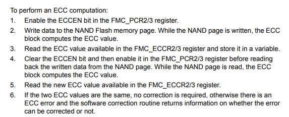

1-It is error detection and possible 1-bit correction, done by CPU and only the ECC computation is done by hardware. In the RM, there is an example use case.
Note that 3, 5 and 6 are done by software.
