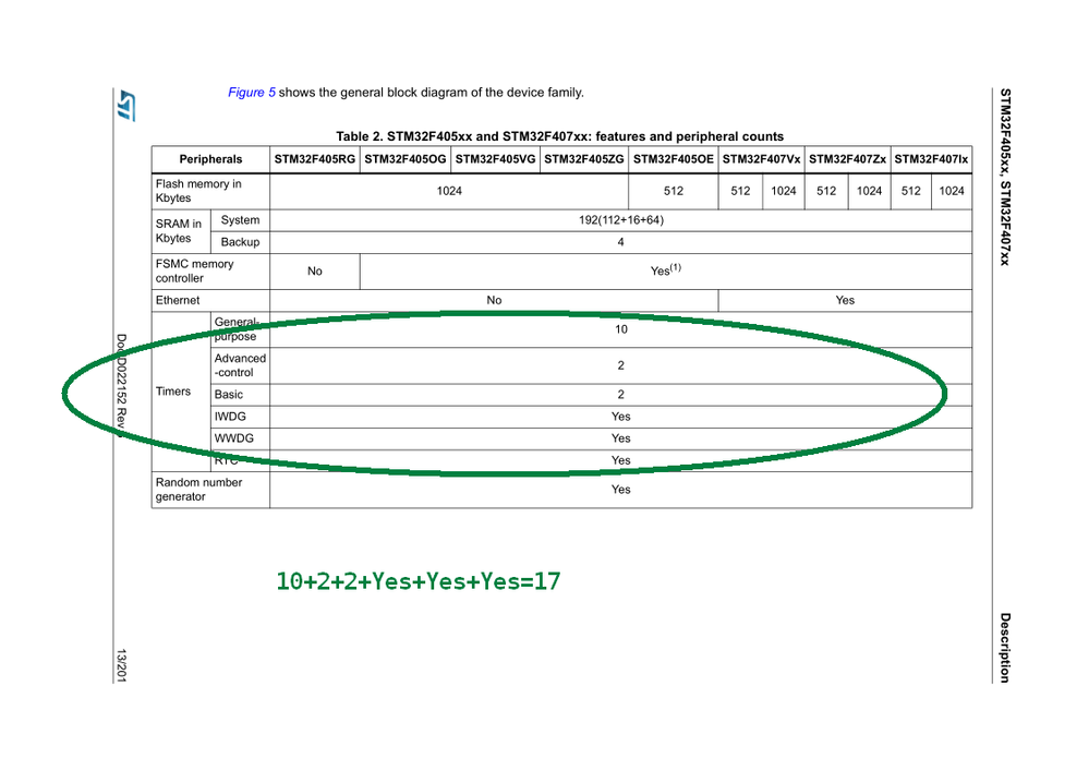

Posted on March 30, 2017 at 22:44
12+2 is 14, even for extremely large values of 2
They count up the RTC, and the two watchdog *timers* - said Table 6 does not show this anymore, but you can see it in other STM32 DS. Funnily, SysTick is not counted.
How about ONE timer with 17x 32-bit comparators, or THREE with 8x?
Fancy to start  ''2017 Easter WishList''? ;)
