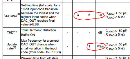

''the Sine Wave has 32 points. Regarding the DAC output settings I have searched on the STM32F42X datasheet, but I have not found this information. Where can I find this information?'' You are not understanding what fm is telling you. ''In addition to clive's hints, you will definitely need to check the DAC output settling time specified in the datasheet.'' Look at the DATASHEET (not the reference manual) : In section ''DAC electrical characteristics'' In the table : look for ''tSETTLING'' and ''Update rate'' The 'update rate' tells you the maximum rate of change (small steps) the DAC is capable of (ie the max frequence it can generate) The 'tSETTLING' tells you the time the DAC output needs to go to the final voltage if it does a large voltage jump. This can also limit the maximum frequency the DAC can generate.2014-03-20 4:25 AM
For the STM32F27x/F29x, it is page 160 ofthe datasheet (DM00071990.pdf):

We are using the STM32405 for the project where I work. It has the same spec for the DAC as you pasted (by the way how do I paste pictures? ) I just looked up the STM32F427x/STM32F429xx data sheet. Surprise, surprise - it is the same. http://www.st.com/web/en/resource/technical/document/datasheet/DM00071990.pdf2014-03-20 6:14 AM

As I found out last year, ST even Copy-&-Past's peripheral components between STM8 and STM32 parts. It makes sense IMHO.It has the same spec for the DAC as you pasted (by the way how do I paste pictures? )
It involves the ''Picture manager'' in the menu, but you need to upload the image in the process. The image itself was prepared with a screenshot tool before. And BTW, the forum software crashed me again at the first try ... ... and again during this post (shame on ST !)

I have checked the datasheet and the STM32F427XX / STM32F429XX have the same values. How could I create a 1.5MHz Sine Wave? Using PWM?Let me know!Best regards2014-03-20 6:32 PM
