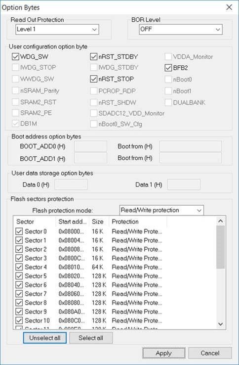

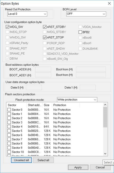

.The starting situation is:
If power cycle the board repeatedly, chaining sector write protection operations, these are the flash options after some resets:
