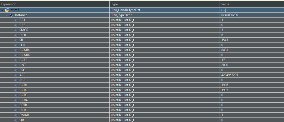

TIM5 has no issue return encoder count with htim5->Instance->CNT

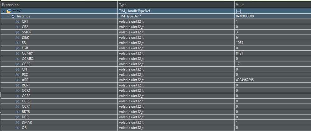

However, TIM2 doesn't return anything.

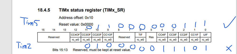

Looking into SR (Status Register) of TIM2
I can see CC1IF & CC1OF bits to be reset for TIM2.
CCR1 & CCR2 of TIM2 are also empty when making the read instruction to CNT.

2023-05-31 11:57 AM
CH1 is not working.
Read out and check/post relevant GPIO registers content.
Measure directly on mcu's pins (think of bad solder joints). Alternatively, set the given pin(s) as GPIO outputs, toggle them and observe.

For binary/hex content of SR registers;
TIM5->SR = 0b11000011111 = 0x619
TIM2->SR = 0b10000011101 = 0x41d

2023-06-01 12:39 PM
TIMx SR are ok.
