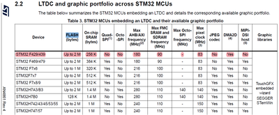

In my case, I referred to the LTDC manual AN4861 provided by ST, and it shows the fastest performance when used for Internal Flash Memory and for the STM32F429II series, it says Up to 2M... I tried using it, but I'm having the problem
