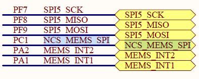

These are the pins according to the datasheet.

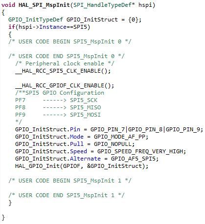

This is an SPI configuration made by Cube automatically. I didn't change anything from here.

*I set pin A1 for interrupt, but I didn't use it for interrupt. Is that the problem? If it's the case then, that might be a very rookie mistake.:grimacing_face:
2021-07-29 5:14 AM
I checked and accidentally, I made PC1 as input. I change that value with GPIO_Output with default HIGH.

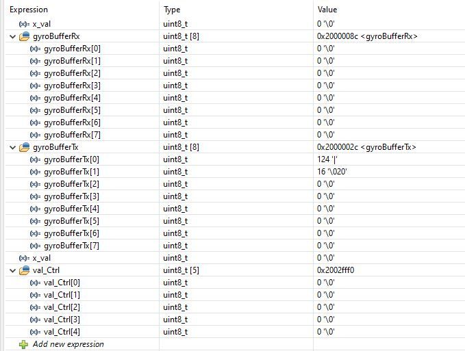

I put a control array to see if I could write anything on-chip. Sadly, the HAL_I2C_Receive function turns nothing (0).

I realize that I cannot always send data through TX or RX, people make chip select high and low every time. So I change my initialize part like this

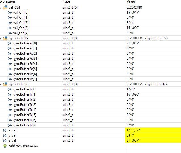

2021-07-29 6:44 AM
WONDERFUL!!
I cannot thanks enough, thanks to you (and all the community) my learning process got speed!
THANKS AGAIN!
