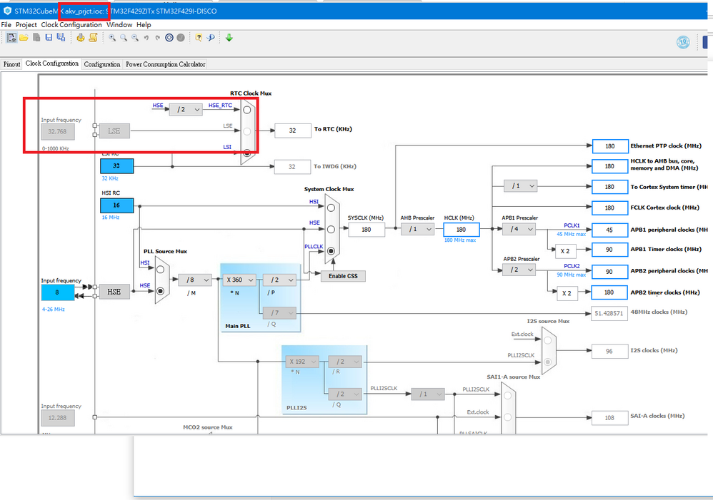

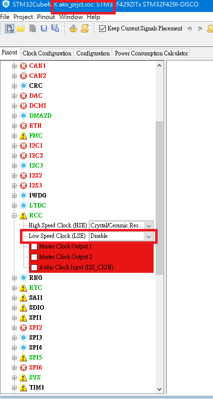

2017-11-19 8:25 PM
Uhm.......I just open your ioc project.
It seems that you didn't even enable the LSE, dude!
So you wan to 'cubeMX' or not?
