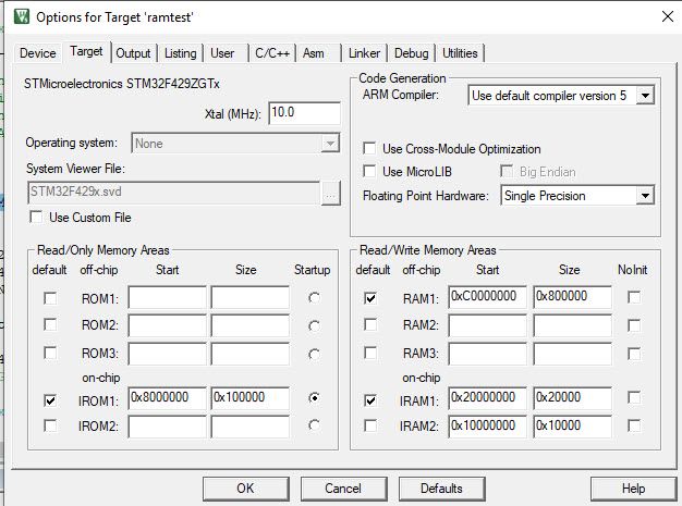

1) Defining external sdram address and size in the linker (off-chip ram)

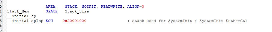

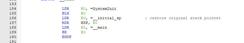

2) Adding some code in startup_stm32f420xx.s

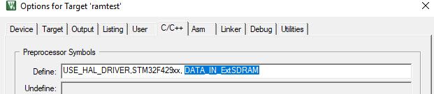

3) Defining DATA_IN_ExtSDRAM for initializing sdram before main function

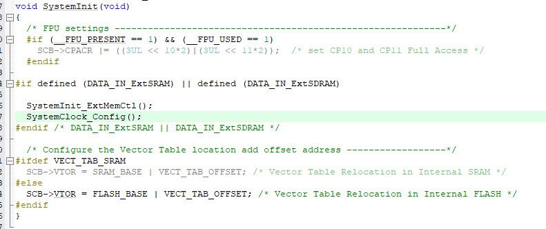

4) Enabling system clock before main function

What is the correct procedure? Is SystemInit_ExtMemCtl() function implemented correctly? Is any modification needed? Is enabling clock before main function and after system_init needed?
Here I attached the modification I did according to my searches and examples.
Can anyone tell what is the correct code step by step?

Look to see how memory regions are mapped in the linker file, and add a specific region that is mapped to where the memory is supposed to be. This tells the linker where it can put things.
