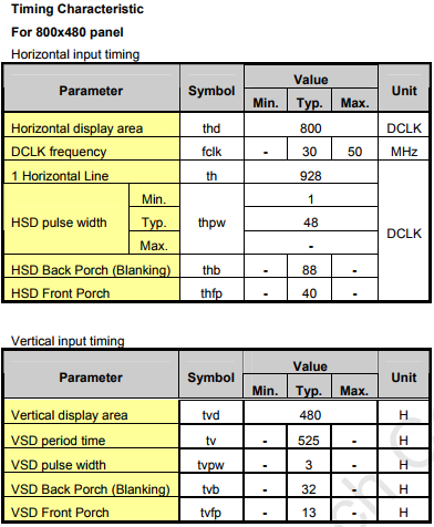

From datasheet we understand that minimum DCLK is 28 MHz. So we are setting the DCLK as 28 MHz and calculated the parameters for LTDC which are as follows.
From Datasheet
HSYNC Width
20
VSYNC Width
3
HBP
46
VBP
23
Active Width
800
Active Height
480
BVBP
23
HFP
210
VFP
22
Calculated Value for LTDC Register
HSW
19
VSH
2
AHBP
65
AVBP
25
AAW
865
AAH
505
TOTAL W
1075
TOTAL H
527

Timing LCD TFT 7 inch from datasheet:
http://www.buydisplay.com/download/ic/OTA7001A.pdf

So what rate are you clocking the display?
How wide is you SDRAM interface?
Understand H7 quite a different beast that F429I.
2019-03-18 2:02 AM
==> 33MHz.
==> 32 bit
For more information, I already config Pixel clock and timings configuration as TFT LCD specification but it does not work.
2019-03-18 2:13 AM
Exact same display, I'm assuming.
Under what circumstances is display tearing? All the time, when image static, when you are accessing SDRAM concurrently? What are caching and MPU settings for memory regions?
2019-03-18 2:18 AM
Display tearing occur when I display a background (800x400) image with rich gradient.
