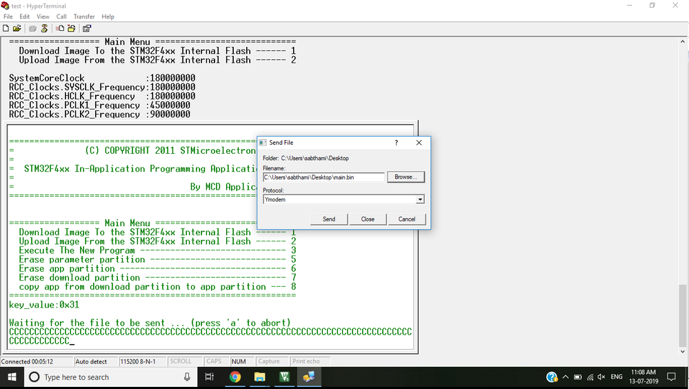

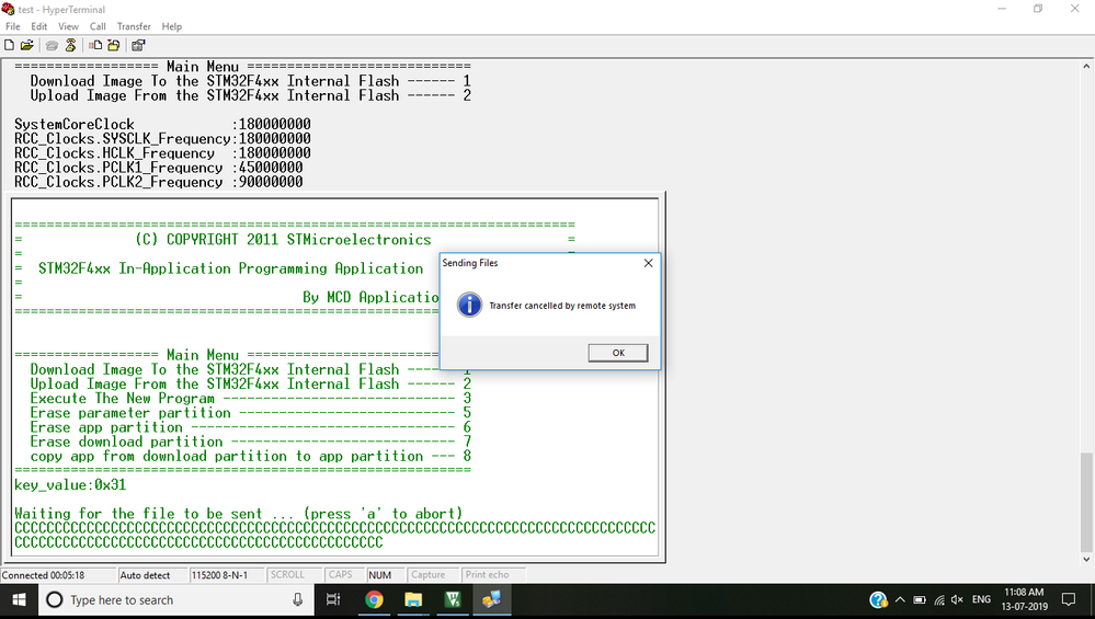

2019-07-12 10:46 PM
Hi i just now figured out what you said that i have send the binary file using Y-Modem protocol. Now i have used hyper terminal to send the file using Y-Modem protocol but in his also i am getting some error when sending the file below i have attached the screen short of my error.
