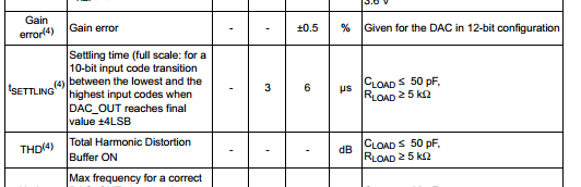

By reducing the interrupt frequency, and the output rate, which is too high. Check the datasheet. The DAC has output settling times in the range of several microseconds, so it can't follow anyway.

I can not find anything about the settling sime.

6 microseconds is the maximum, for full swing and max. capacitive load.
You DAC feeding frequency will depend on the accuracy of the output curve you need (which I don't know).It is not necessarily an interrupt frequency, you can prepare a value table and feed it per DMA into the DAC. But interrupts at 800kHz is absurdly high, you waste most of CPU performance for interrupt entry + exit.2014-11-13 3:09 AM
