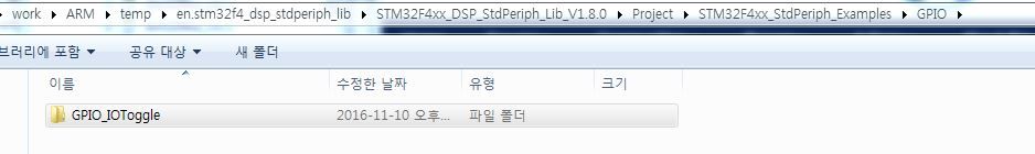

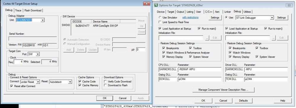

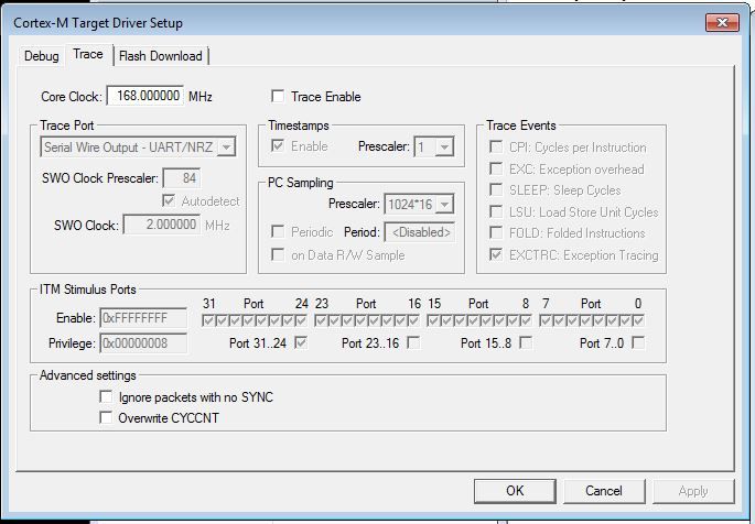

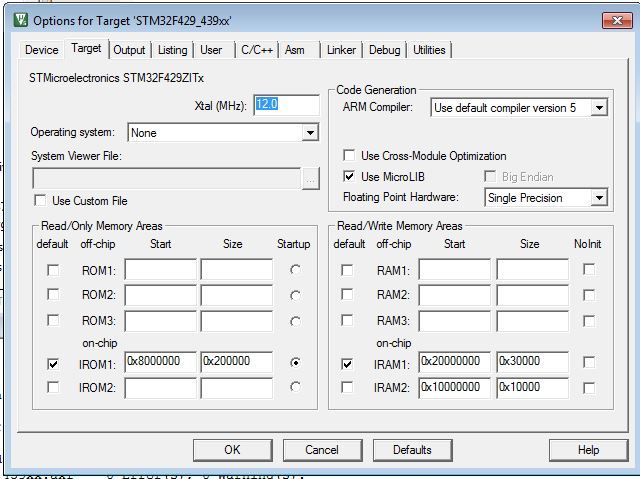

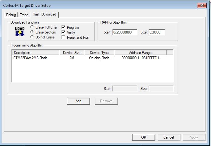

Hi.
I've done set up the \STM32F4xx_DSP_StdPeriph_Lib_V1.8.0 with keil and  think the flash download works good.
So I'm trying to implement GPIO_IOToggle test with
STM32F4xx_DSP_StdPeriph_Lib_V1.8.0's
template project
After compile, there is no error and I've uploaded to flash my firmware.
But LED does not work. I think there are some mismatch between STM32F429-disc1 kit and
STM32F4xx_DSP_StdPeriph_Lib_V1.8.0's GPIO declaration.
STM32F429-disc1 ki  have just 2 leds  and it's connected PG13 and PG14. but there is no PG13 and PG14.
