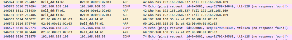

I was originally using STM32F207, FreeRTOS, LWIP ,ENC28J60 , system works fine.
Because I need more RAM, I migrated to STM32F427, but unfortunately network no longer works now, ARP seems working but Ping fail (Request timeout)
