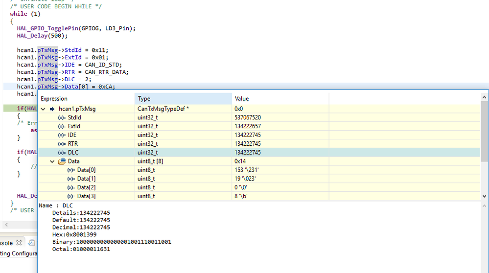

Then what is received by my Can monitor is 0x240 A6 A7 03 CE Here is a screenshot of the object 0690X00000605LIQAY.png It almost feels like I have a clock issue. But i'm fairly certain I have it setup right.

Just Matt
Associate III
Posted on February 04, 2016 at 17:44
I feel like an idiot.
static
CanTxMsgTypeDef TxMessage;
hcan1.pTxMsg = &TxMessage;
