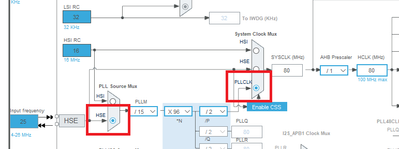

I meant to use this config:
For the clock (if the crystal is at 25MHz). Please ensure you have 25MHz.
and CAN bit timing:
