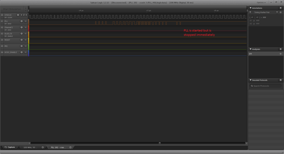

We tested the MCO pins. Clock frequencies seem normals.
We noticed that sometimes the PLL clock stopped. But we do not know if it is the micro which crashes and stop the PLL or the PLL which stops and crash the micro.

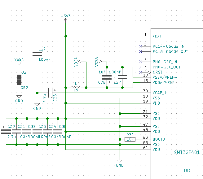

Hi, d
id you solve the problem?
Ihave an identical problem but with STM32F401RBT6, on nucleo all works, on my PCB fault as above. Errors are sometimes different(INVSTATE, PGSERR, PRECISERR, BFARVALID, BFAR, MMFAR, PGSERR) and occur in a random program location, at about >50-60Mhz, regardless of the periphery.
EDIT: The problem solved ... the Vcap 4.7uF capacitor must be really low ESR, or better 2x2.2uF.Below my configuration. I added extra 100nF for NRST.We’re moving the ST Community to a new platform to give you a better and more reliable community experience.
