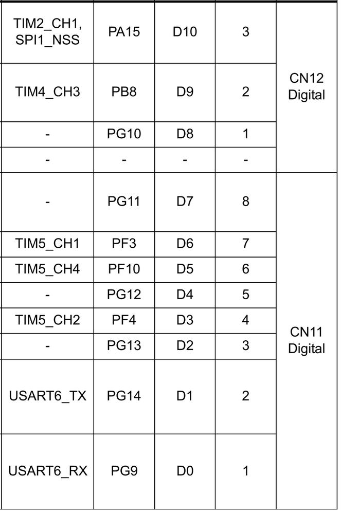

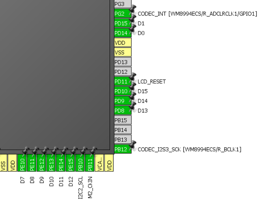

When I create a project in CubeMX 4.25.0 with the STM32F412G-DISCO board, the arduino pin assignments are all wrong.
I have attached a partial screenshot of the CubeMX project showing the incorrect assignment and a screenshot of the user manual's pin assignment.
Is this likely to be corrected in a future update?
I don't think this is likely to cause problems as enabling the USART6 peripheral, for example, can't be set to D0 and D1 (PD14 & PD15) in CubeMX but it does cause a bit of confusion when trying to assign peripherals.

2018-05-09 5:51 PM
I have found the source of confusion and it is not due to incorrect pin assignments but because the arduino connector has the labels marked as D0-D13 and the D0-D13 I was seeing infact belonged to the LCD - although maybe they should be marked as LCD_D0 etc... to avoid confusion for future updates.
