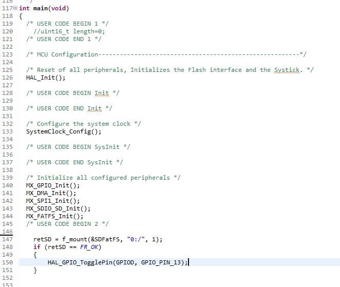

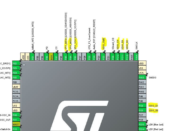

Forget all of the questions above... I think you might be a little confused.
I added the CubeMX pin setting as a photo.
It's not in the picture, but I added SDIO TX and RX as DMA.
I'll talk about symptoms again.
SPI has been set up, but it is not being used.
Before entering while(), there is a problem initializing f_mount inside the main(). ( in the code, line 147)
F_mount is returning FA_NOT_READY.
I don't think it's a HW problem because using SDIO for other projects works well.
