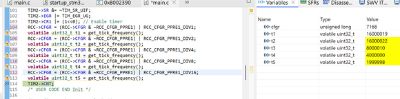

i have a STM32F114 (Black Pill V3.0) and a strange timer problem. We all know that when setting the APB1 clock divisior is > 1, the APB1 timers gets twice as fast (2x, TIMPRE bit is not set). However, my timers are 4x when the divisor is > 2 (RCC_CFGR_PPRE1_DIV4, RCC_CFGR_PPRE1_DIV8, ...). It doesn't matter if i use HSI, HSE or PLL as sys clock source. My timer interrupt is twice as fast compared to a APB1 divisor of 1 or 2:
APB1 divisor = 1: timer interrupt each 0.1 ms (10 KHz)
APB1 divisor = 2: timer interrupt each 0.1 ms
APB1 divisor = 4: timer interrupt each 0.05 ms (20 KHz)
I checked different frequencies (16 MHz, 48 MHz and 100 MHz sysclock). AHB and APB2 divisors are 1. I used two STM32F114 devices for testing. I double checked everything.
Code:
// reset state assumed, HSI is 16 MHz
unsigned long cfgr = RCC->CFGR;
cfgr = (cfgr & ~RCC_CFGR_HPRE) | RCC_CFGR_HPRE_DIV1; // AHB clock = 16 MHz
cfgr = (cfgr & ~RCC_CFGR_PPRE1) | RCC_CFGR_PPRE1_DIV8; // APB1 clock = 16 Mhz / 8 = 2 Mhz
RCC->CFGR = cfgr;
RCC->APB1ENR |= RCC_APB1ENR_TIM2EN;
TIM2->CR1 &= ~TIM_CR1_CEN;
RCC->APB1RSTR |= RCC_APB1RSTR_TIM2RST;
RCC->APB1RSTR &= ~RCC_APB1RSTR_TIM2RST;
TIM2->PSC = 4 - 1; // 2 MHz (APB1 clock) x 2 = 4 MHz
TIM2->ARR = 100 - 1; // Timer should be called each 0.1 ms
TIM2->DIER |= TIM_DIER_UIE; // Enable timer interrupt generation
TIM2->SR &= ~TIM_SR_UIF;
TIM2->EGR |= TIM_EGR_UG;
NVIC_SetPriority(TIM2_IRQn, 1);
NVIC_EnableIRQ(TIM2_IRQn);
TIM2->CR1 |= (1<<0); // Enable timer
