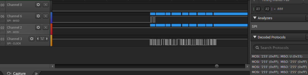

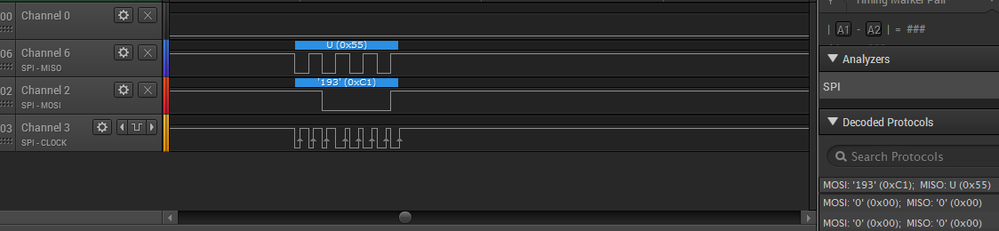

i'm using an STM32F407ZET6 with SPI1, SPI2, SP3 and SWD. SPI1 and SPI2 are always working fine. SPI3 works when the CPU is running without debugging. Whenever I set a breakpoint SPI3 Clock (PortB3) has strange pulses. I checked how to disable JTAG on STM32F4 in RM0090. It shoud be done automatically when Changing the Pin Configuration: ... GIO_InitStructure.GPIO_OType = GPIO_OType_PP; GPIO_InitStructure.GPIO_PuPd = GPIO_PuPd_NOPULL; GPIO_InitStructure.GPIO_Mode = GPIO_Mode_AF; ... And changing the Alternate Function mapping: GPIO_PinAFConfig(SCK->GetPort(), SCK->GetPinSource(), GPIO_AF_SPI3); Both is done in my code and as SPI3 is working (logic analizer and SPI-Chip is responding) as long as I break debugging via breakpoint or halt.2015-01-12 2:11 AM

the attached movie didn't help, this is just how to activate the route to IAR. But on IAR i-Jet there was an extra Feature -> Project-Properties -> Debugger -> I-Jet/JTAGjet -> Trace Trace data collection Mode: None The J-Link does not have this Feature. I tried connecting to J-Link via GDB Server and after that, SWO is no longer reactivated. So I guess it's again an IAR related problem. IAR still didn't answer yet (not a good sign with a valid service and update license agreement for 820 EUR / year) Thank you for your help2015-01-19 11:04 PM
