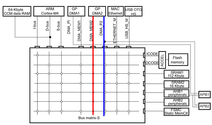

Hi I am using STM32F407ZET6 Microcontroller and I want to use multiple streams of DMA1. Is it possible to trigger two different streams of the same DMA for transferring data to two different peripherals simulatenously. (Like in Parallel).
In the advanced AHB bus matrix I observe that for each DMA there are only two lines, one for memory and one for peripheral, which suggest to me that at any time at max two streams can perhaps run in parallel and that also if none of the streams are really doing memory<->peripheral transfer. Is this assumption correct? And, is this also correct that to run two streams in parallel through a single DMA they should not be doing memory<->peripheral transfer? what I mean is that by the look of AHB matrix it felt if only Mem to Mem and Periph to Periph transfers are done then probably two streams can run in parallel, but if any one of them does memory<->peripheral transfer then the use of DMA memory and peripheral interface for a single transfer will probably make that NOT possible. Can you shed some light on this?
I would like to request some guidance on this particular topic as i could not find satisfactory information on it... And if it is dependent on the bus bandwidth to transfer streams in parallel then how the bandwidth is divided among multiple channels for a single bus to perform multiple transfer.... Some If there is any such example, i would be thankful. As a reference I have put the AHB matrix below:

> What I meant was that I don’t expect DMA2 to be able to allocate e.g. Stream* 1 to one of those
> interfaces and Stream 2 to the other.

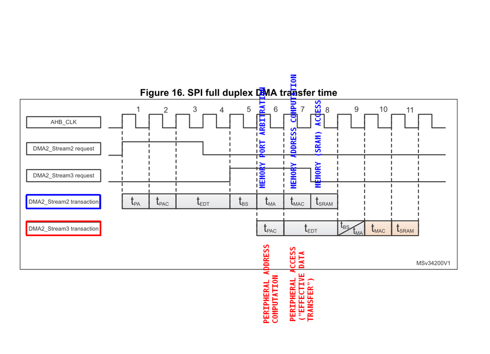

The two ports have separate arbitrators. Thus, if one stream transfers on memory port, the other can simultaneously transfer on peripheral port. This figure from AN4031 illustrates it:
