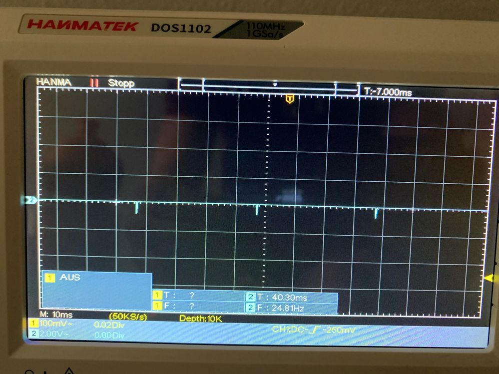

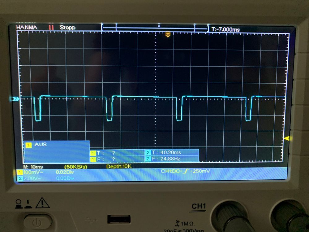

Where and how do you measure that voltage? Can you show oscilloscope screenshots for the two different cases?
2020-12-14 12:12 AM
Hey Jan,
sure! Here are pictures with the delay set to 80us / 3000us.
2020-12-14 2:11 AM
Can't this be just your oscilloscope's limitation?
Do you measure after some optocoupler? If yes, try measuring directly on mcu pin.
