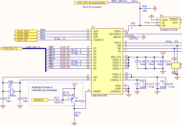

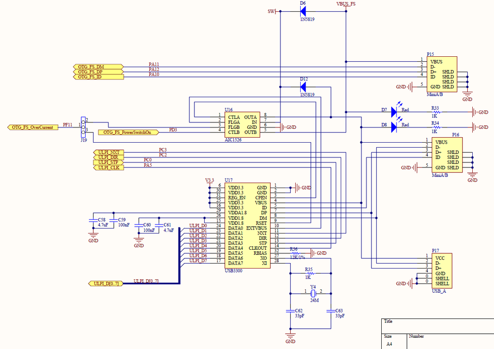

i designed schematic for stm32f407 and usb 3317 but i dont know how to connect their port together...please help me...Thanks2013-08-21 1:58 AM

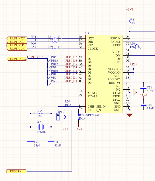

Have you looked at the STM3240G-EVAL schematics (USB_OTG_HS.SchDoc)? It's a different chip but the signals look similar.
2013-08-21 5:52 AM
what connector should i use for usb3317?is the 475900001 good for it from the point of speed?
2013-08-21 8:00 AM
Assuming you mean the MOLEX Part Number: 47590-0001 Micro-USB AB Receptacle, Right Angle, Top Mount, SMT, Lead-Free - why not if it suits your needs. It seems to be what ST used.
Before you ask me another question, I haven't designed or built High Speed USB. You should look at guidance on the internet regarding controlled impedance connections and tracking. See FTDI's website and look up AN_146_USB_Hardware_Design_Guidelines_for_FTDI_ICs.pdf. Good luck.2013-08-21 8:21 AM

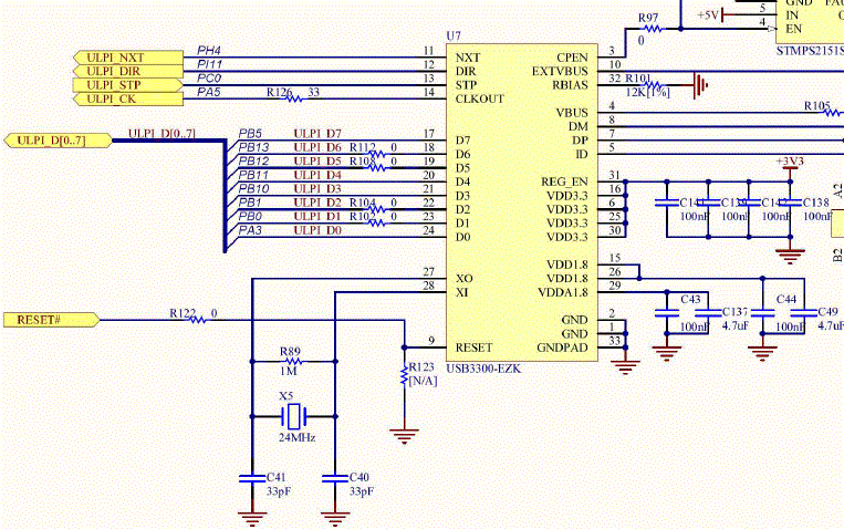

Download the User Manual UM1461: STM3240G-EVAL for the STM3240G-EVAL Evaluation board for STM32 F4 series - with STM32F407IG MCU evaluation board from ST's web site. The schematics are on the later pages.
2013-08-22 8:40 AM
2013-08-22 9:07 AM
I'm not authorized to do that, what I posted should adequately show the STM32 side connectivity.
I've seen others with pretty much direct connections on the USB, but that doesn't strike me as a very industrial solution. I would probably suggest you look at other USB3300 reference designs.2014-07-26 9:55 AM
