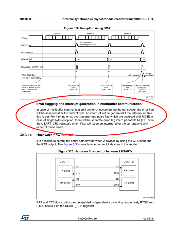

ORE can't generate itself an interrupt but is associtate to receive flag RXNE that generate Uart interrupt. Or rather the Uart interrupt must check the status of the error bits when receive a byte
The Uart RX interrupt (RXNE flag) will be generated also if configured in DMA mode ?
In the figure you posted there is a comment say the DMA clear the RXNE bit. And this is resonable DMA read the Uart DR register and the read access at Uart DR register reset the RXNE to zero
___________________________
Sorry after write my reply I read one more time your previous reply and I think I understand
EIE flag !!! enable Uart interrupt where I can check the Uart error bits ...
Now is clear
