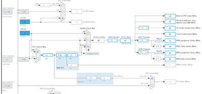

1.Clock configuration
I have decided to use TIM2. According to the STM32F407 Block diagram (STM32F407 Datasheet ) , this Timer connects to AHB/APB1 hence I have set the APB1 to 48MHz to achieve the required Clock frequency for the neopixels.

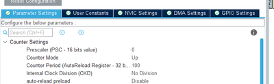

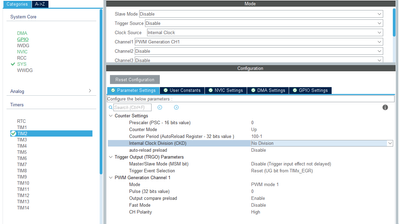

2. Timer configuration:

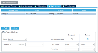

3. DMA configuration:

1. What is the correct Length to pass to the HAL_TIM_PWM_Start_DMA in my particular example?
Since I only want to send 24 bits ( 3 bytes ), I should call I pass 3 or 24 as length? In the example post that I initially refered the guy is using 24 but I am slightly confused.
2. What is the correct DMA data width. Currently, I have set to Word but I am not fully certain that this is correct.

The correct length to pass to the HAL_TIM_PWM_Start_DMA function would be 24, since you are sending 24 bits of data.
The correct DMA data width would be half-word (16 bits) since the data being sent is 16 bits (2 bytes) per LED.
How did you come up with that conclusion? For each Neopixel LED I need to send 3 bytes (not 2).

My DMA settings:
Mode: Normal
Direction: Memory To Peripheral
Data Width: Word
My timer settings (Clocked at 84MHz)
In my code, I simply try to generate 8 waveforms with increasing duty cycle:

If you want to send uint32_t values, the DMA has to be set to word width. If you want to send uint16_t, it should be half word.
2024-03-04 9:01 AM
It's not just matter of "you want". TIM2 is 32-bit, its registers are word-accessible. If you write 16-bit values to its registers (regardless of whether via DMA or processor, except that it would require extra work with casting if you'd do it by processor), the AHB/APB bridge doubles the halfword into both halves of the word, resulting in surprising behaviour.
