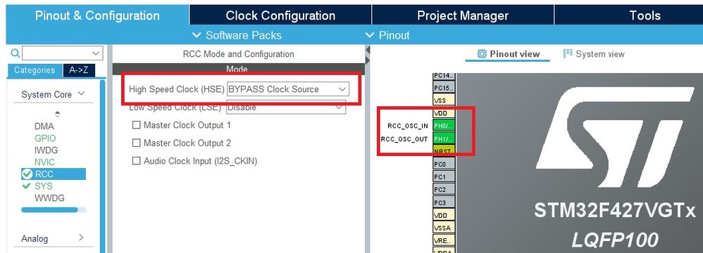

STM32CubeMX 6.3.0, FW_F4 v1.26.2 Firmware, "Pinout & Configuration" TAB -> Categories -> RCC -> High Speed Clock (HSE) BYPASS CLOCK SOURCE. Then we see on "Pinout view" signals RCC_OSC_IN + RCC_OSC_OUT with green enabled pins PH0/OSC_IN and PH1/OSC_OUT.

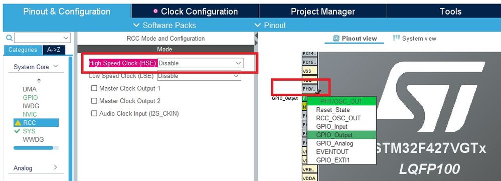

Now try to setup PH1/OSC_OUT pin as GPIO. HSE BYPASS disabled and conflicted with text explanation "High Speed Clock (HSE) Conflict with PH1/OSC_OUT mapped with GPIO output" (see screenshot below).

> Is it possible to configure PH1/OSC_OUT pin as GPIO when HSE BYPASS (external clock generator on PH0/OSC_IN pin) is enabled?
No.
