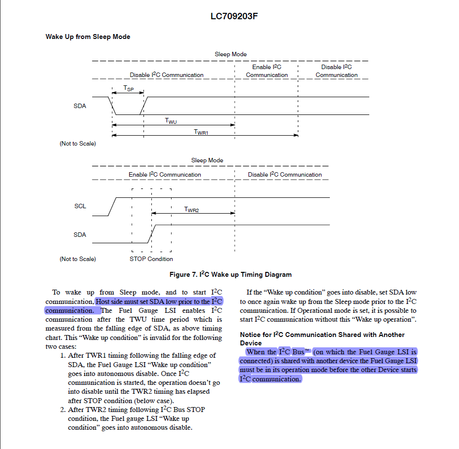

I'm using LC709203F to measure RSOC. It is going to sleep mode after 1.2 Ms.
To wake up from sleep mode , I have write 0x0001 to register 0x15 in fuel gauge.
Prior to that , I have to set SDA line to low for particular time.
Please help me to set SDA line of I2C low for particular time either using HAL or register

Which STM32?
Just set SDA's pin GPIO_MODER field from AF to Out (from 0b10 to 0b01) and do whatever you need through its GPIO_BSRR (->ODR); when finished, change GPIO_MODER back to AF.
#define AND &
#define OR |
#define GPIO_Mode_In 0x00 // GPIO Input Mode
#define GPIO_Mode_Out 0x01 // GPIO Output Mode
#define GPIO_Mode_AF 0x02 // GPIO Alternate function Mode
#define GPIO_Mode_AlternateFunction GPIO_Mode_AF
#define GPIO_Mode_Analog 0x03 // GPIO Analog Mode
GPIOB->MODER = (GPIOB->MODER AND ~(0
OR GPIO_MODER_MODER6
OR GPIO_MODER_MODER7
)) OR (0
OR (GPIO_Mode_Out * GPIO_MODER_MODER6_0) // SCL
OR (GPIO_Mode_Out * GPIO_MODER_MODER7_0) // SDA
);JW

I'm using STM32L452. I have attached the image which instructed by LC709203F(Fuel gauge that I'm using) for your reference.
