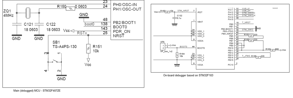

I'm not keen on bonding pins to the supplies, would use pull up/down resistors.
I'd check that the boot0 and BOOT0 nets actually connect. I'd check the code in ResetHandler on forwards.We’re moving the ST Community to a new platform to give you a better and more reliable community experience.
