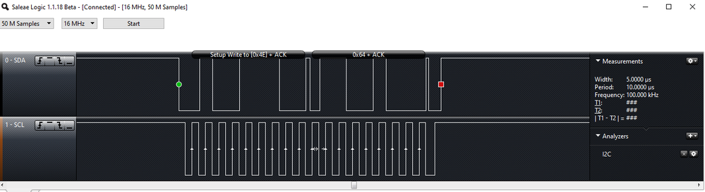

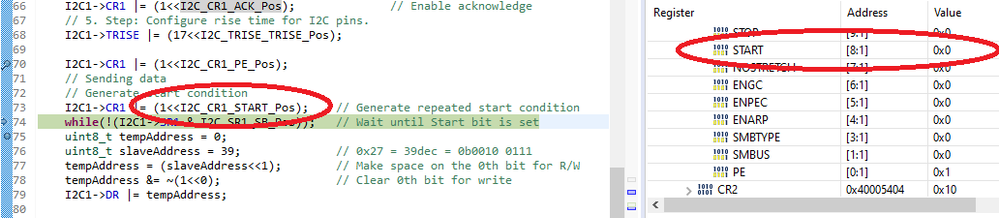

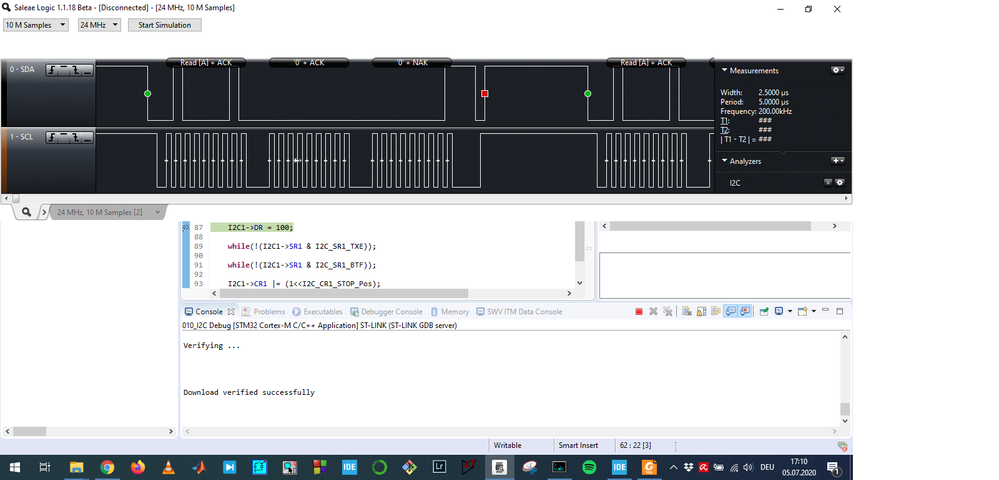

2020-07-05 9:13 AM
2020-07-05 11:31 AM
Hi TDK
sorry for being a pain in the a**. I need to clarify that I probably messed up my project before so the measurements cannot be trusted. I noticed that when I tried to clean my project which failed to do so, and I needed to restart my computer. With that being done, I managed to run the below code and I can measure the signals on my logic analyzer. I first send the address followed by 100 (0x64). However, perhaps I am misreading the graph, but I fail to see the acknowledge by the slave after the address is send. Shouldn't in the 9th clock cycle be the acknowledge bit pulled high?

I2C1->DR = tempAddress;
while(!(I2C1->SR1 & I2C_SR1_ADDR));
uint32_t temp1 = 0;
temp1 = I2C1->SR1;
temp1 = I2C1->SR2;
(void)temp1;
while(!(I2C1->SR1 & I2C_SR1_TXE));
I2C1->DR = 100;
while(!(I2C1->SR1 & I2C_SR1_BTF));
I2C1->CR1 |= (1<<I2C_CR1_STOP_Pos);
// I2C1->CR1 &= ~(1<<I2C_CR1_PE_Pos); // Turn off I2C1
2020-07-05 11:51 AM
Oh wait. I am wrong on this one. On the 9th bit, an ACK is considered a logic low on the SDA line. So in fact, the address phase is acknowledged. And so is the data transfer of the 0x64 on the data line. On the 9th bit, SDA is logic low as well.
So it seems that my I2C is working as intended. That's great. :)
Now I just need to understand how to control the LCD with that. :)
Thanks for your support :)
Cheers,
