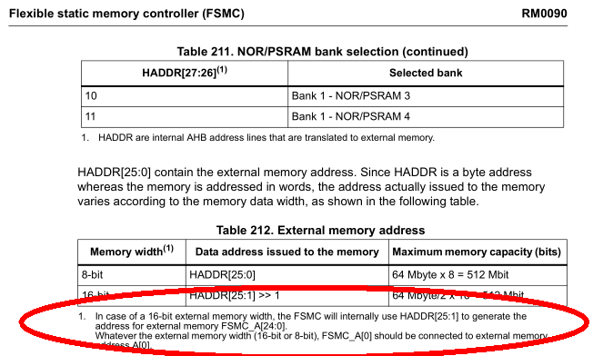

I believe it may be not entirely clear especially for those who don't have much experience with 16/32-bit buses interfacing, but the following remark is relevant to the case (an older v11 of RM0090, but I believe the current v15 has it in the same way):
2017-07-07 7:15 AM
Hi JW,
Thank you very much for your anwer.
OK I've read too quickly the chapter and I've missed this important remark !
The remark is written in section 36.4.1 table 213 inside RM0090 rev. 14 manual dated of april 2017

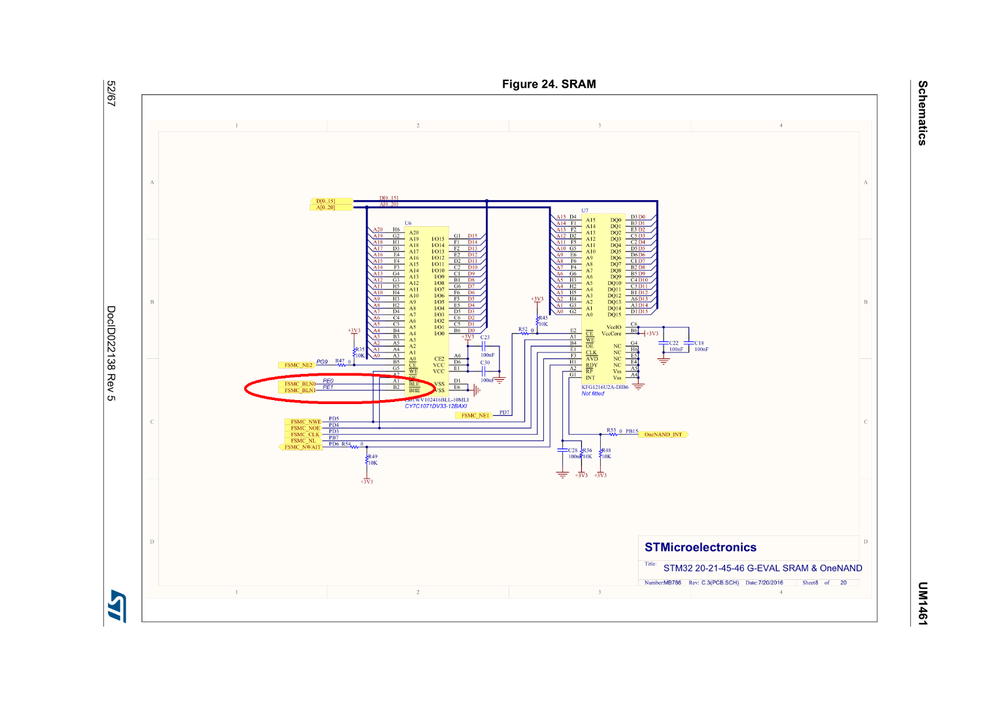

For example, this is a 16-bit SRAM as used on an EVAL board:

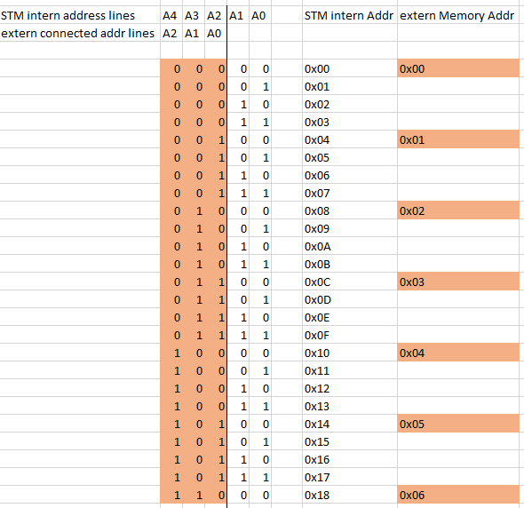

Hi JW,
In my project I need address lines A15-A0 for my external memory. The databus is 32-bits width. This memory is shared with another microprocessor to exchange data between my STM32 and the other processor and the memory is controlled as a SRAM. All data is stored at fixed addresses in this memory, some of them I can only read and some I can read and write. This memory is 64KB in size.
The problem is this extern memory is byte-addressed. So at every address there is one byte stored. So when I want to read the byte at address 0x04 at the external memory I have to set the internal address of STM to 0x10, because of the address shifting by two (see my table, the red one is the physical memory connection from A2-A0). I connected A0 to A0, A1 to A1 and so on. STM shifts the address by two and so intern address line A2 is then the address line A0 to my memory.
Its a bit confusing, I set my MPU region as none cachable from address 0x60000000 with the size of 64KB. But with the address shifting by two, do I have to set the memory size to 4*64 KB? To address the last byte in my memory (address 0x6000FFFF) I have to set the internal address in STM to 0x6003FFFC. This address is then shifted right by two.
So I have to calculate the external address before I can access any byte. As example I want to read the byte at address 0x06, so I calculate the internal address to 0x60000018.
Or is there an other more easy way?
