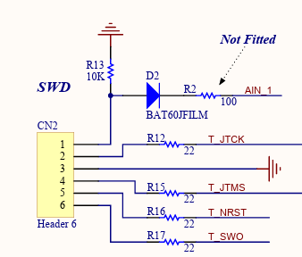

Now, I was only using the stlink part of the card to program another stm32 microcontroller. While running it in debug mode, I cut off the power of the card and it remained in debug mode all the time, in a way that I cannot understand now, and a connection with the card cannot be established in the cube ide program or utulity, cubeprogrammer programs. I get the error that the card is kept in reset mode. When I feed the NRST pin with 3 volts, I get a short connection. I only reset that much chip, but I think the problem is only in the stlink part. Can anyone help? I hope the problem is understandable, I will add the errors as well.
The LD1 pin of the card is on green, in this case, the stlink is not recognized in the Cube IDE program, when I remove it and insert it again, the code is not thrown. After the lalin LD1 turns green and red, the steady green light, which is the reset mode, turns on.

Ok sir, I am using stm32cubeIDE as debugger. I am also trying to connect with the STM32 ST-LINK Utility program. St-Link connection was made by removing the SWD pins of the target MCU and the CN3 jumps of the disvovery card. I give the pins.
