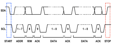

After the initialization the SDA and SCL should be at the high level :

The idle state of an I2C bus is that both SDA and SCL are high, so that's rather a good start.
I don't know the F407 discovery board, so is that an on-board sensor? Then hopefully the designers did the right thing and placed some pull-up resistors on the I2C signals.
Anyway, check all I2C communication with a scope, with only 2 wires and for a temp sensor probably only a few bytes it's not too hard to decode.
> ... and after reading the data from the sensor, pin B9 got stuck pulled low.
That sounds like a not issued stop state.

If SDA is stuck high low, it suggests the communication was halted and the slaves are still expecting more clocks from the master. There is nothing to solve here, it's just a shortcoming of the I2C protocol.
To reset, toggle SCL 9 times on startup (by initializing as an GPIO OD output and toggling) before initializing it in I2C mode.
Note that I2C lines should have external pullups to ensure they are idle high immediately after powerup.
