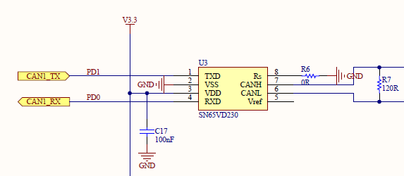

I have the same Problem. I have already tested various programs. I have started with the CubeMX and its configuration, went over to the StdPeriphLib. I only tested to send something from the Discovery to a Vector CAN Interface. I also watched the tx pin with a scope and recognized that tht tx pin at the STM goes from low to high when program starts and then never does anything.
I am using Keil uVision in its latest Version. I am very confused that the pin isnt doing anything. Attached is my cubemx main file. ________________ Attachments : main.c : https://st--c.eu10.content.force.com/sfc/dist/version/download/?oid=00Db0000000YtG6&ids=0680X000006HznJ&d=%2Fa%2F0X0000000bPl%2FiM_2rSZDZ08oeEG9S_sX9qtrOFlVUrTZ1.M1mYZAnvo&asPdf=false2014-11-17 8:06 AM
I'm not a subscriber to HAL/CUBE, you'll have to find someone who's interested.
I will observe that there doesn't appear to be any pin configuration for CAN usage, the signals don't magically route themselves out of the chip, and the bus timing looks ill considered.2014-11-20 1:32 AM
Hallo
I am using STM32F429ZI for the first time and I need to implement an CAN Bus Communication of tranmsitting and receiving the messages.I am using TJA1041AT CAN transreceiver and to see the messgaes I am using PCAN BUS View.Herwith I am attching the program which I got ur from this website and in this I am facing the few problems. 1.I am not able to set the baud rate to 500Kbps. 2. I want to know on how to change the initalization from CAN1 To CAN2 ________________ Attachments : CAN1_TO_CAN2-Normal_temiz.rar : https://st--c.eu10.content.force.com/sfc/dist/version/download/?oid=00Db0000000YtG6&ids=0680X000006Hzdo&d=%2Fa%2F0X0000000bPi%2FrTKcZxXxIREB3hdhlOSoQXnu0ksQoVgNGCyDGnobZwA&asPdf=false2014-11-20 8:46 AM
CAN_InitStructure.CAN_Prescaler = RCC_Clocks.PCLK1_Frequency / (14 * 500000); // quanta by baudrate - 500kbps
APB clock would need to be cleanly divisible. CAN2 is a slave to CAN1, so you'd need both clocking. You'd need to change the pin/AF configurations, and the FIFO settings. With the standard split of resources CAN2 would be using 14..27We’re moving the ST Community to a new platform to give you a better and more reliable community experience.
