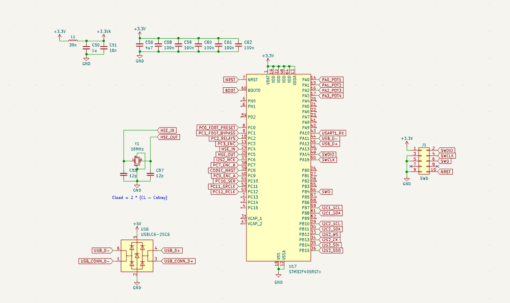

Hi guys, this is my first post here on the forum. I'm starting my learning in STM and I created a custom board with a STM32F405RGT6, I followed a basic MCU operation schematic that I found in a video on Youtube, but the MCU is not starting. I did several tests to check if the USB connection was correct, if the voltages also worked well and everything is ok. However, I saw that I really don't get a clock from the crystal, the crystal I'm using is already known to me from other projects. So I'm leaving here a print of the connection schematic and if anyone can give me some light on where to look for the problem that causes the MCU to not start, I would be very grateful.:grinning_face:

Also, I didn't notice this at first glance:
You're connecting OSC_IN and OSC_OUT to PC4 and PC5 while it should be connected to PH0 and PH1 like provided in the datasheet:

You need to refer to the STM32F4 hardware getting started AN4488 and refer to the schematics.

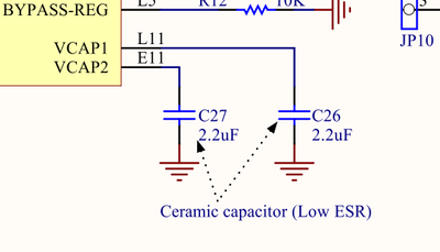

From your schematics at least VCAPx capacitors are missing:

Hi guy, thanks for your reply. I have already done all the checking on my PCB and the schematic is being fully respected, I am a guitar pedal manufacturer and have a lot of experience with custom boards from other MCUs (Atmel and ESP). Can you see a connection error or a pin that should have a connection and is floating in the image I attached?

My attitude must be very noob, but I was just hoping to connect the MCU via USB and some device would appear on the computer, apparently this isn't the initial step, right?
Is the connection header I created (J1) or is there a pin missing from it? I have a ST LINK-V3 MINI DEBUGGER, should I use it to do this initial MCU configuration?

Did you fix the VCAP errors? Going to be hard if you didn't put any traces/pads on those pins. Is the voltage on VCAP ~1.2V?
