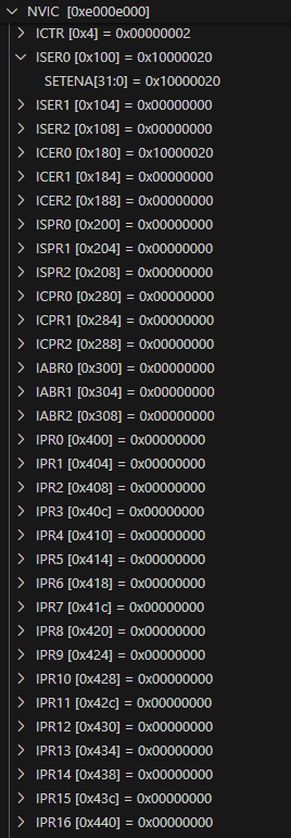

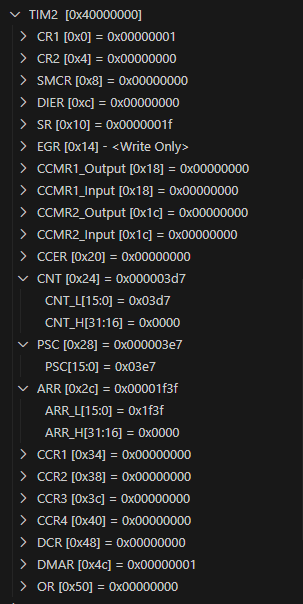

I forgot to call
TIM2-> DIER = TIM_DIER_UIE;
Is there a HAL Function to set TIM->DIER ?
These are the values of the peripheral TIM2 and NVIC. Timer 2 is counting.
2024-03-25 4:55 PM
Read out and check/post content of TIM and relevant GPIO registers.
2024-03-26 1:28 PM - edited 2024-03-26 1:43 PM
I forgot to call
2024-03-27 4:52 AM
Thanks for coming back with the solution.
I don't know, I don't use Cube/HAL. Probably there's a macro. Cube/HAL is open source.
However, I believe, under Cube/HAL you are not supposed to set TIMx_DIER directly; you are supposed to call some of the HAL_xxx_Start_IT() functions (or something like that) which do this for you. Read the HAL/Cube documentation (which is mostly the comments to functions which you can see also in the source code).
