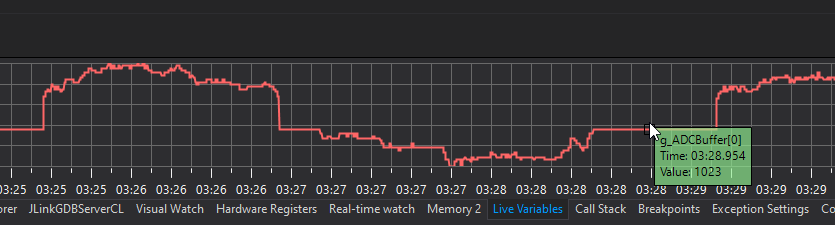

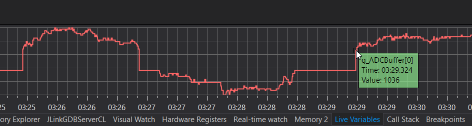

This is a zoomed in graph of the output values, even with the noise the value between 1023 and 1036 can't be reached.

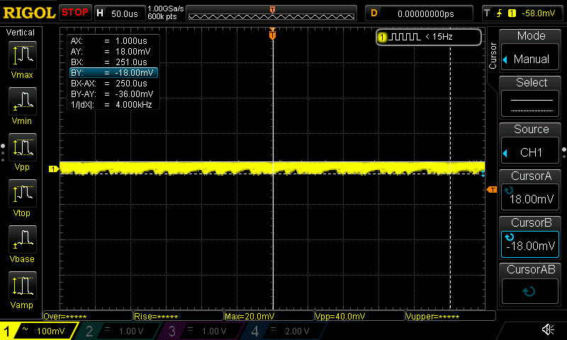

2020-05-29 4:38 AM
2020-05-29 4:41 AM
See the picture above ! Missclicked the reply button
Vref is the output of a NCP51460, it has no decoupling at its output though.

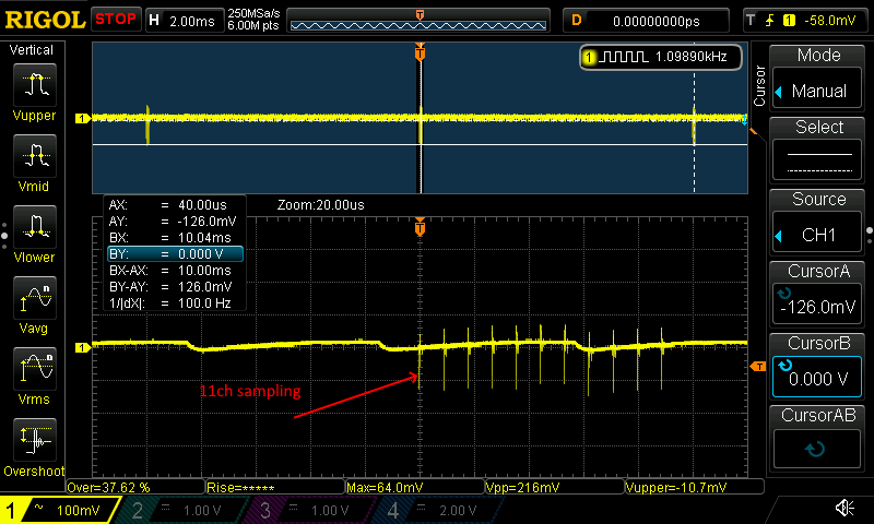

2020-05-31 5:10 PM
Mystery has been solved ...
We added a 100nF on the VREF pin and it solved the problem.
Since we wanted to inspect the behavior ( for educationnal purpose :) ) we removed it and scoped the Vref pin and look what we have found :
Almost 100mV drop when sampling
The Vref uses an ncp51460 to get its reference. In the ref design there's not decoupling cap but ... seems that it need some to sustain the sampling load.
