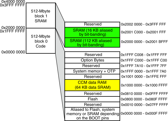

Hi, I have STM32F407VET6 which has such memory layout.
As I understand CCM data RAM is unused by default and just waits to be used? So can I move STACK and HEAP to it? How do I move it? (I did not find defined STACK address anywhere in KEIL project)
Is there anything else I could use CCM for?
