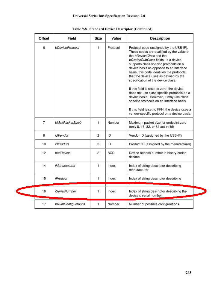

2017-10-12 2:26 AM
How is possible to provide an unique USB serial number?
You provide it as an index from the Device descriptor to a unique String descriptor.
If you are using some ''library'', find the place where the descriptors are defined, find how the Device descriptor is defined, find this index within it, find where does it point and modify the string. If it's zero, find out where the String descriptors are defined, add one and then add the appropriate index. You need different string for each hardware. The ''real stuff'' is to generate the string on the fly e.g. from the STM32's UniqueID, in that way you'll have the same firmware.
