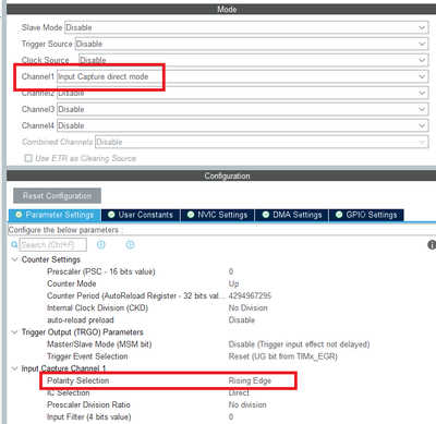

I don't know what you intend to do but I think at least you need this config:

What I want is to count the number of overflows of timer
x on a GPIO input (10 Mhz) and interruption on 1 input (1Hz signal)
at each rising edge.
