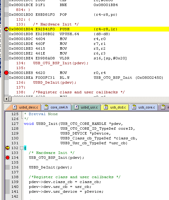

Well, now about the term “random�?. When I put the compiler at optimizing level -O3, all worked well. But I prefer to disable optimization when I debug. In this case, the compiler generates FPU instructions before I have the opportunity for enabling the FPU from C code.
See image bellow.
2012-04-11 4:46 PM
The package you cite is ST's own release
Keil has some of their own variants preinstalled, see \Keil\ARM\Boards\ST\STM32F4-Discovery\Blinky I'd have to look at the optimization, do you have some float code in your application? I'll have to try something like #include <stdio.h> #include <math.h> void test(float x, float y) { printf(''%f\n'', (x / y)); } int main() { test(22.0, 7.0); while(1); }2012-04-12 8:52 AM
I tried to find the reason for the generation of V* instruction, but without fortune. I removed all my modules that use floating point and played with optimisations. Bellow is an image of C optimization level -O0 generating V* instructions (bellow the PUSH instruction). This happened in a call to a USB initialisation:2012-05-15 8:31 AM

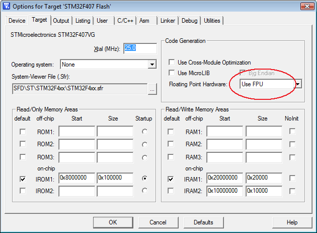

Don't want it generating FPU instructions, and/or don't want to enable the FPU, make sure the project sets the ''Floating Point Hardware'' option to ''Not Used'' instead of ''Use FPU''.
