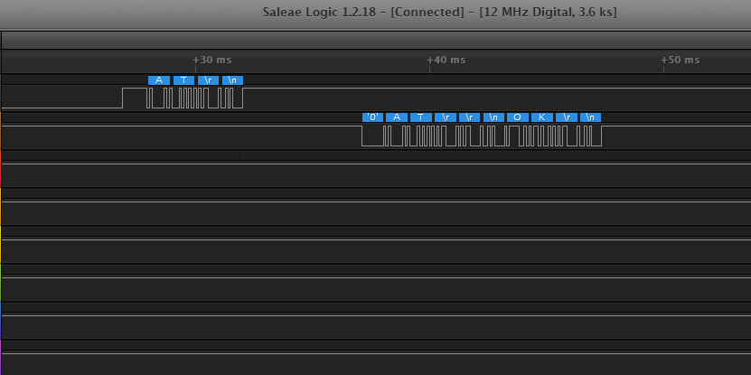

As seen at the screenshot from logic analyzer after command "AT\r\n" SIM module send response.
But receiver in STM can't see it...

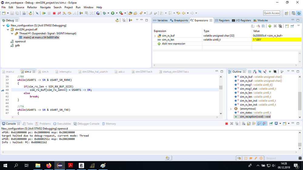

Screens from debugger

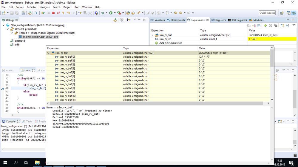

Microprocessor receive only one byte of value 127.
I have no idea what could be wrong.
Does anyone have any ideas?

I'd probably use a proper ring buffer.
Watch for other error status on the USART blocking reception.
Don't inspect the USART registers from the debugger.
