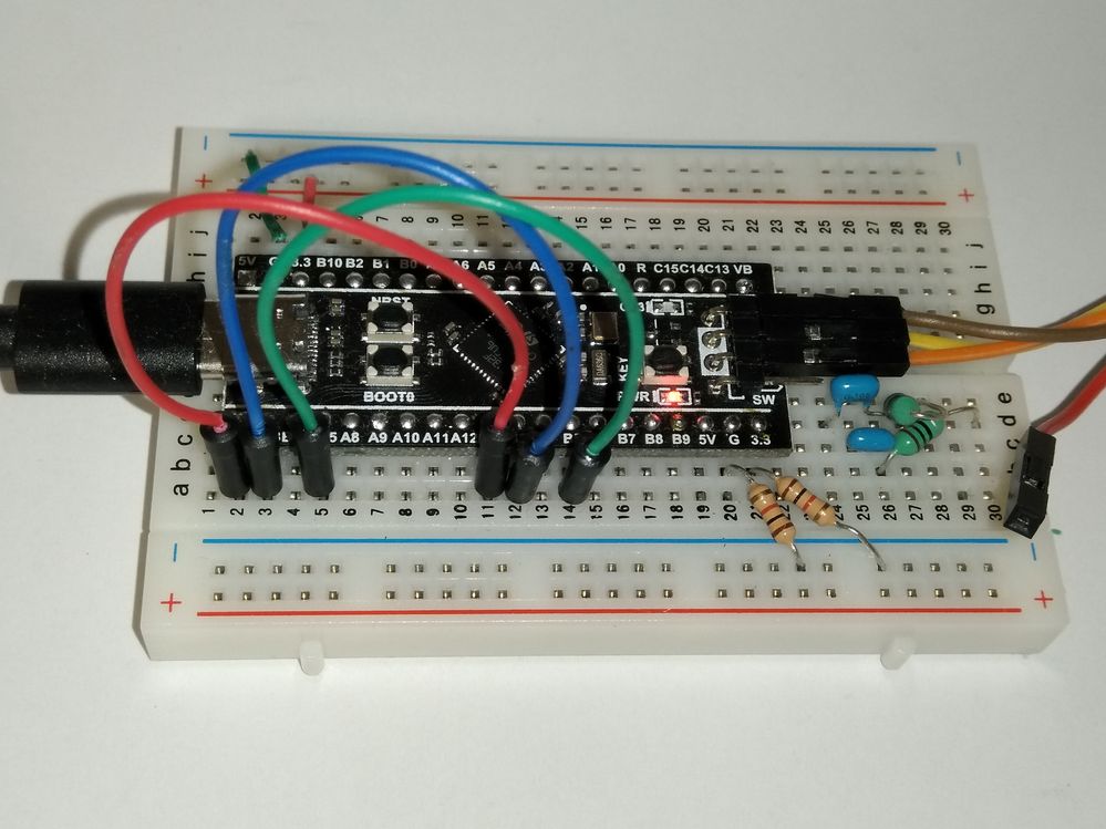

Dear Jan,
Thank you very much for your reply. Your comment is very encouraging.:smiling_face_with_smiling_eyes:
Unfortunately, I do not have Oscillo or Logic analyzer. But my test bed is very simple.
Therefore, I need check the received data.
In 16bit in 16bit data frame case, I thought loopback data (received data) is OK, but it was NOT.
Received data is unexpectedly SHIFTED. (see red part) [PDF attached]
And In 24bit in 32bit data frame, received data was DISASTROUS!!!
If you (and anyone!) have any idea what is wrong, please enlighten me.
Many many thanks in advance.
K.A.
