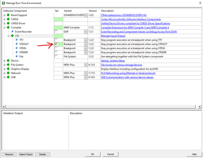

….after some googling I found that KEIL has ability to redirect STDOUT stream. This is apparently done by ticking checkbox (red arrow) in RTE settings:
Above picture says variant “Breakpoint” – “Stop program execution at a breakpoint when using STDOUT”.
One can change variant to “User”:
…then it says “Redirect STDOUT to a user defined output target (USART…..”
This sound like something I need.

I chose variant “breakpoint” in RTE settings and changed back function name to “int fputc(int ch, FILE *f)”
…..and
printf("TEST_");
started behaving as expected. It transmits messages TEST_ as they come, each 1000 ms.
I can not explain why is this working.
I don’t know whether I have been clear enough, solution to my problem was ticking checkbox and leaving variant “breakpoint”, nothing else needs to be changed. Now I get “TEST_” in standalone mode (visible via UART to USB bridge).
