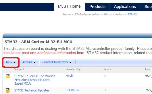

Excuse me for being irrelevant, I'm new here and don't know how to create a new post! Can you guide me with that?
2016-11-19 2:07 PM
Sign into forum Go to the ''STM32'' forum page, listing the threads Go to the upper left corner of the thread list, and click the ''New'' tab.2016-11-19 2:14 PM
2016-11-19 2:38 PM
Thanks
