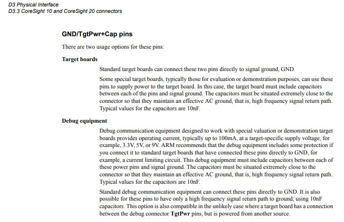

I see the STM32F429I-EVAL board has grounded the "GND/TgtPwr+Cap" pins 11 & 13. Any idea where I can find info on the meaning of "TgtPwr+Cap", and when that is used?
2021-07-28 3:28 PM
https://developer.arm.com/documentation/ddi0314/h/Chdfccbi
