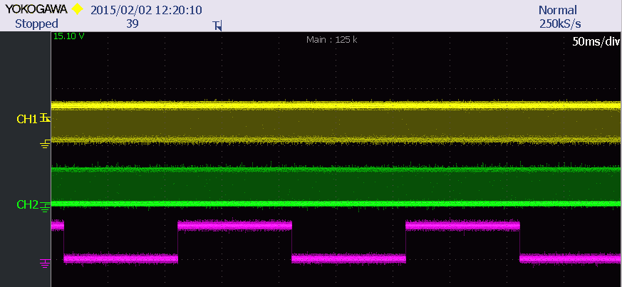

In the following picture, channel 1 and 2 are CH1 and CH1x respectively, and channel 3 is the pulses generated by GPIO_ToggleBits(GPIOD, GPIO_Pin_12) I added before the switch command.

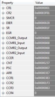

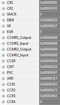

I asked you for *all* TIM1 registers' content. TIM1 (and TIM8) has more registers than other timers.
> CR2 == 0x3F01 Do you understand the implications of this, especially the CCPC bit being set? JW2015-02-02 5:20 PM
Thank you so much for pointing out CCPC. I should have read the manual more carefully. Now everything works fine. Thank you very very much.
