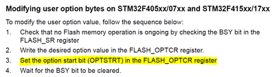

Seems a lot of people have problems programmatically setting the ROP level, I tried using the default code on an STM32F407VGT6 and it doesn't use the 0xBB level to protect at level 1, but 0x55...but it doesn't work.
Cube Programmer allows it to be set to 0xBB and that does work.
So I tried 0xBB programmatically, and it still doesn't work. Though set, after a reset the 0xAA value returns.
Here is the code if anyone feels inclined to close this issue with a few lines of code that actually work:

2023-08-12 10:08 AM
You need to set the OPTSTART bit to apply changes to the option bytes, as described in the reference manual.

2023-08-16 7:31 AM
I would say "Finally an answer to an 11-year old thread!"
**bleep**, missed the second unlock, unlock Flash, the unlock option bytes, will try that! Thanks for posting!
